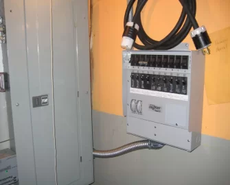

bought a Genny couple years ago and it has really come in handy during power outtages..
hooked up a 10 breaker transfer switch into the Main panel so we can run 75% of the house....
due to sensitive electronics board, we run the oil furnace instead of the Harman just in case..
that ugly black chord connect the genny to a 30 amp outlet outside on the porch which leads to the transfer box.
that ugly black chord connect the genny to a 30 amp outlet outside on the porch which energizes the transfer box.
Ya I couldn't locate an 8 or ten breaker panel for decent money or in stock locally and Lowes had the six breaker in stock, so I installed that. It's been quite a few years now, you might think I would have changed that out by now but can't justify the expense, go figure ! Well I say that because the essentials are covered, heat, hot water, cooking, refers, some lights and coffee. An outlet in each bathroom and the downstairs bathroom is lit in a power outage. What more can one need in an emergency ?

booght it online from Reliance.. think it was 300.00 or so..
1 thing we didn't hook in was the Electric stove since that would take up the 30amp spot. we use either the outside grill or microwave, or Takeout lol.
my tranfer box is all interchangeable so was able to PULL the 30 amp breaker out and put in 2 -20 ampers in that slot which gave us couple more rooms to energize..
Mine is a Reliance Controls as well. this one : http://www.electricgeneratordepot.com/reliance-controls-indoor-transfer-switch-5000w-20216a

yes. I remember seeing that at HD..Actually, it is a standard item always there at this HD...
I bought my Generac 7500 watt online and remember seeing the Reliance Interchangeable 10 breaker puppy.
only took me close to 6 hrs...!!!.[ Pro Electrician would have done it in couple hrs] to hook everything up including running the 30 amp outlet from the panel thru the basement to back porch. btw:
if your like me when doing anything Electric[unless your a pro] you check, double check, triple check each step before you go forge ahead. and then do another check for good measure..
