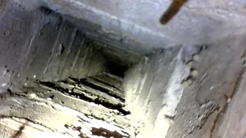

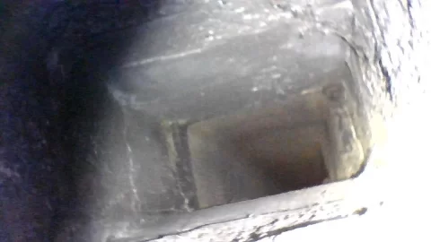

I'm not sure to be honest - i took a few photos tonight from the cleanout. It looks to be probably more than a foot wide? (that sounds big?) Hard to gauge size but looking in the other flue it appears to be standard cinder block width and length minus the liner (16" x 8"). My endoscope does not focus at distance very well.
"second flue" (left photo) is the side that would house the new stove- appears to be just cinder block up until the 2nd floor (which is where the flue comes in). The liner looks like it starts at least 4-5' below where the flue enters. The right photo (with visible soot) shows the current stove in the basement - you can more clearly see the liner
