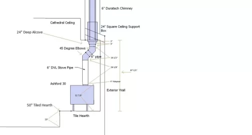

Just a quick question. Can you use and adjustie piece of DVL stove pipe between 2, 45 degree elbows?
The adjustable pipe I'd use would be the 12" one (adjust from 2"-10") to change the offset and rise height.
