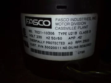

Arnash,
The lubrication issue was a thing that I ruled out based on the knowledge of the combustion motor in my Quest Plus. As you can see on the pic it's a 230 Volt motor requiring no oil.
The 120 Volt version in Robert's stove is probably different, so a few drops of oil may do the trick ;-)
