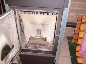

You don't mention setting the draft, believe your stove and my Maxx-M should be similar burn mechanisms. On Maxx-M there is a slide-gate across the output vent, this determines amount of combustion air - there is no other control for that though. I tend to adjust it for each pellet and then only touch it when changing feed by a lot.
As for pellets dropping they will still burn and add heat but agree it's annoying. I added a piece of metal across the gap from burn pot to chute and it helped, see pic. Extra points if you guess what I used ;).
