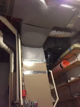

I was thinking of just installing this furnace as a standalone with a few registers leading to the first floor, but after reading some of your suggestions, I realized that it might be an interesting project to install this furnace in parallel with the existing LP furnace. I read a bunch of posts and was all motivated until I took a good look at my plenum. See the plenum photo. There is a nice area right where the furnace ends and the plenum starts that unfortunately has my AC coils and the coils go right up into the center of where all those ducts connect. In other words, I wouldn't know where a could put a backdraft damper in such a setup. Any suggestions about this?

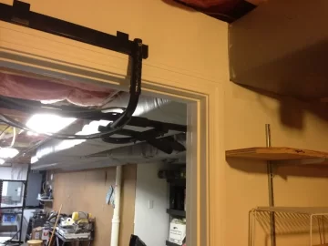

With this in mind, my second issue is where to install the pellet furnace. I can install it to the left of the furnace or the right...that's it, but neither would be close to the furnace. The back wall (wall behind where I stood to take the photo) has a large deck running its entire length. The front wall (on the other side of the furnace) is just a partition leading to the finished basement and the front of the house. 25' to the right, I have en empty chimney flue. 35' to the left, I have a concrete foundation. I have quotes to vent into the chimney (with an insulated liner) or through the foundation. Prices are about the same. I prefer going up the chimney because the other wall would require a hole through the concrete foundation slightly below grade to clear some electrical and LP lines and I am not too crazy about that. Any recommendations/opinons/comments about the chimney install versus the concrete foundation install?

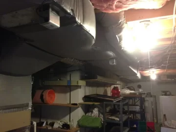

Again, keep all of the above in mind... On the left side (through foundation install), the furnace would be close to 1st floor and 2nd floor supply and cold returns ducts (see photos). On the right side (flue install), the furnace would be near a 2nd floor supply only. The 1st floor and cold return find themselves on the finished side of the basement. So, if I cannot install a damper at the plenum, would access to the various ducts mentioned above affect your choice of installation location?
