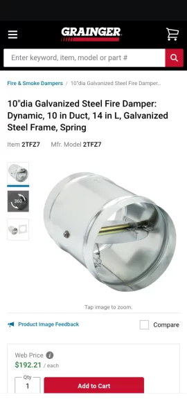

The above is the fire damper looking to use.

My plan is to add a 10" duct centrally located on 2nd floor to be able to move the cool back to the 1st floor. The stairs to 2nd floor would path up for the heated air which is right next to stove.
My question is what fan speed/flow rate would a person be looking to use for purposes of creating a recirculation loop. Beyond the fire damper is there anything else the setup would need to keep insurance companies happy? I am out in the rural county so isn't much code enforcement.
Not sure why grainger link got removed, see attachment.

The best circulation will be with the return placed at the opposite side of the stairwell. At the end of a hall would be ideal as long as there aren't doors closing off the air flow path. Usually this is done with a through the floor, fire-dampered duct and matching register.
