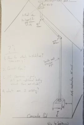

So I am at that point that the barn is constructed, but the shingles aren't on yet. I know where the stove is going to go, but I have a few questions. I drew up a little drawing with a few questions on it. Any advice is greatly appreciated! You can tell me anything, even if you're crazy, not even close, looks good, stupid idea. I have thick skin!
Thank you all!

Are you doing the bend inside the building because you don’t want to see much stove pipe out the top of the roof? Seems like straight through the roof would make your stove breathe a lot easier.
Yes inside the building. I want the stove in the corner, but I don't want 6 feet of pipe outside roof. Code is 3' above peak 2' above anything within 10' (which honestly makes no sense to me)
Sent from my SM-G950U using Tapatalk
I'd put the pipe straight through the roof and just have a bunch of pipe outside. Its a shop/garage man. It looks fine on homes, let alone garages.
How do you plan on annually cleaning out that section of interior piping?
To me, that is a total waste of time and extra pipe. Double walled pipe isn't cheap either.
