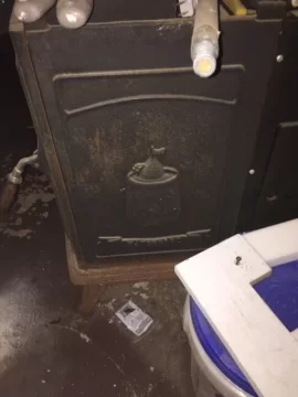

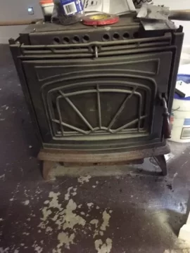

Love these forums. I currently use an old wood stove downstairs in my home. My mom has a pellet stove that she doesn't use and thinks it needs servicing. I could use it upstairs. [Hearth.com] Advice needed please... [Hearth.com] Advice needed please... [Hearth.com] Advice needed please... The only thing I know about the stove is that is says Waterford on the side. Anyone know anything about this stove? Thanks all!
Should be a plate on the back cabinet that would have the model name and manufacturer. Looks like it may be a Waterford "Emerald" pellet stove that is discontinued by Regency. Manual https://assets.regency-fire.com/get...-8393-c1fbac665588/Emerald-Pellet-manual.aspx
Why did Mom stop using it? I would suggest cleaning it up outside with compressed air before you install. Pay particular attention to the exhaust pathway.
I took another look at the pics and would suggest a bit of a touch up on the rust. Stove Bright or VHT found in automotive stores.
Thank you. She said it didn't work, but I think she probably didn't want to spend the money to fix it. I figure I could take and spend some money, if needed, to fix it and then use it as a heat sources upstairs. I am NOT one to do this myself so I will have to have someone come out and check it out. There is a Regency dealer down the street from me.
Give it a good cleaning as a large portion of stoves that do not work are improper cleaning. The manual seems to be better than most as far as troubleshooting. I would suggest that if it is outside, leave unplugged and disconnect the vacuum switch and blow out the exhaust passages with compressed air or do the leaf blower trick on the exhaust outlet on the back. Warning ... it will be messy. Reconnect vac switch, plug it in and give it a try. It would be helpful to at least give the shop symptoms to work with and it may be something really simple.
