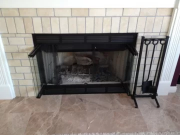

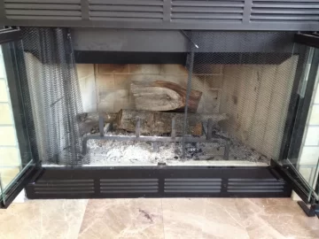

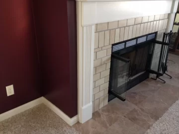

I am going to try and up load a few pics of what I got...hope these can explain better what I'm wanting to do.

If you can get the proper clearances to combustibles with a combination of heat shielding and air space yes you can put what ever you want in there. But I seriously doubt that just lining the inside of your opening with dura rock and sheet metal even with an air space is going to get you any where near that. you also need to check the requirement for clearance to the ceiling in an alcove install it is usually fairly high. You will also have to check requirements for floor protection for the insert you would be installing but 2 layers of durarock and a layer of sheet metal is not enough for most.

[Scratching my head] Let me get this straight. You want to rip out your present (looks to me) ZC fireplace and replace it with another ZC to install a wood stove insert inside of. Or just install an insert without a ZC fireplace with just durock around it.
No. Big no to the latter. There are only a few generally smaller inserts that can be installed in ZC fireplaces and only where the insert mfr indicates ZC is allowed (even then, your ZC mfr should be saying it's okay too). Pretty sure the Buck 91 is NOT one of them. (download the install manual and check to be sure). It's big, 8" flue, catalytic, and likely requires either a masonry fireplace or be installed with legs as a freestanding stove with appropriate clearances and class A flue.
If you want to burn wood efficiently for heat (vs. ambiance only), then either pull out your present ZC fireplace and replace it with a high efficiency EPA rated ZC fireplace (which is basically a woodstove insert built into a ZC fireplace). Or pull out the ZC and install a freestanding stove in its place with a new class a flue. Or find one of the smaller inserts that will fit your present fireplace and you will also need to install a full SS liner--room for attaching the flue outlet on the insert to the liner may be a problem. I know Travis (Lopi) has a few smaller ones that are rated for ZC and there are some others.
