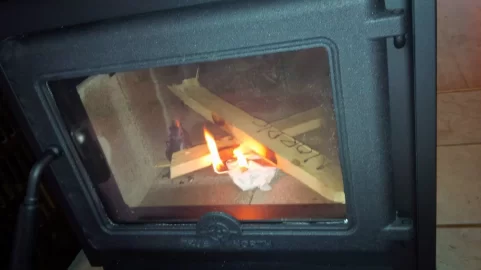

First small fire to cook the paint:
[Hearth.com] Advice Please!
