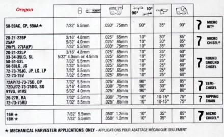

Here's the standard chart from Oregon boxes showing the three angles.
  • [Hearth.com] Advice/tips on chain sharpening needed
None of the chains I use now call for the 10 degrees so I need not to worry about it correct?
One of the things I like about the folks on this forum is that when asked what time it is, you all give enough information on the subject to build a clock. Lots of good stuff here.
That Oregon chart is pretty interesting. Especially the part where it distinguishes between holding the file perpendicular to the bar (which it calls 90 degrees) and holding the file at a slight upward angle (which it calls 10 degrees). What is fully about this is that if perpendicular is 90 degrees, then this measurement is given with reference to the plane that the bar itself sits on; but the 10 degree measurement is given with reference not to the plane the bar sits on, but rather to the plane perpendicular to the bar. In other words, if 90 degrees is perpendicular, then a slight upward angle from that is 100 degrees, not 10.
