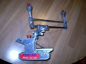

    I have one of these, pretty much the same thing as the file and joint.
    I think it does a good job. With some practice it is just about as fast as filing freehand but more accurate.

    Wes, my problem is that when i am over on the farm the sharpening is done off this.
    cant beat bringing it home to the vice.
    and like i said before, i have to have something to help me as i cant keep a straight line on the chain..
    i seen that at home depot the other day.
    Terry
