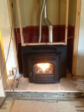

Been seeing a lot of discussion about OAKs and didn't know what the heck that was until a recent post. I have an Integra installed in an existing masonry fireplace. Should I be looking for a way to get fresh air into the stove or is it alright as-is?

Interesting. I wouldn't think it'd make that much of a difference, but I guess it's something I'll have to try. The challenge in my case is that I'm working within an existing masonry fireplace with a 12' chimney. Maybe next year.
Just had an install done, and they ran the OAK , in the same 8 inch pipe as the exhaust , only goes up about 6 ft
(replaced a free standing wood stove) [Hearth.com] AF Integra Insert - OAK Necessary?
Not an option for me - I'm working with 3" straight pipe all the way up. I'll probably look into running a second line for the fresh air down the chimney next season.
