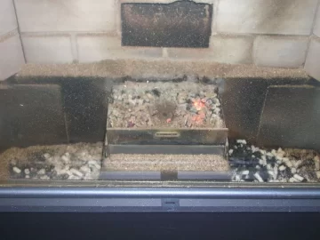

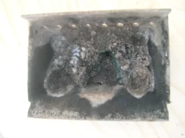

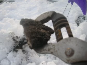

I had my burn pot fill up again last night. I have good draft, all my blowers are working well. My burn pot is full of ash and its clumped up in there. It was packed in like damp sand. I checked the vent under the burnpot and its clear. I dumped the pot and fired the stove, the flame looks good... Strong fire, good draft. I took a few pics. I have a fluffy tan ash inside the firebox Could I be burning wet pellets?

Is that blue I'm seeing in the burn pot, middle picture?
Looks like someone was playing around with a copper based compound.
Get a couple of bags of something else and try them.
As for the ash, you should see gray almost white if the air/fuel mix is correct.
It will usually be black otherwise, now if you are burning a high fuel to air mixture there will be a tendency to have a brown haze deposited on the glass, can't say I've ever seen brown ash from burning wood.
Looks like clinkers to me and big ones too! A friend of mine was burning lignetics with the same results as you are getting. He was stirring the pot 3 times a day to keep it going. He finally returned them for another brand seem's his stove was fine. I tried the lignetics in my multifuel stove and never had any issue's burning them.
I would look around for another pellet to try. This will rule out the stove. If the next pellet burns good. There might be an issue with the lignetics and your stove. Some stoves are just pellet picky. Thats why I bought and recommend Multifuel stoves. Far less pellet issue's. Or just maybe Lignetics might have issue's this year! Hmmm.
What other brands do you have available near you?
What do you mean by "copper based compound"? Could be a bluish gray color, what does that mean?

1BadTitan said:
A blue or blue green tint is associated with compounds that contain copper such as copper sulfate which is used in a number of products including garden fungicides.
I just happened to note a blue tint that is all.
Inorganic compounds (such as metal sulfates, are usually present in larger amounts in some wood, if any of that gets into pellets they will have one of the required things to form clinkers. Temperature, moisture, and time in the burn pot will then work their magic resulting in clinkers.
