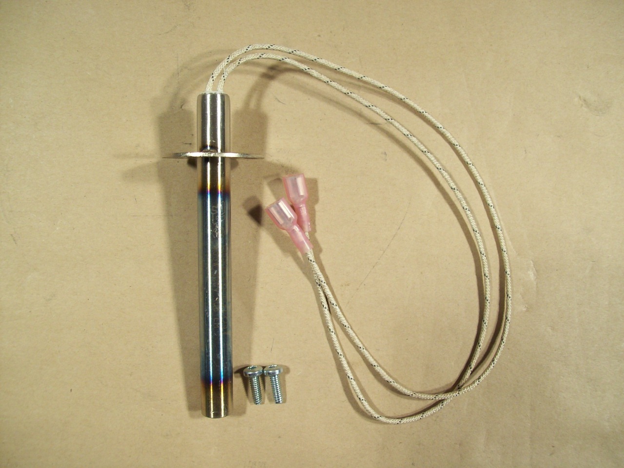

So I did a bench test with the ignitor. Should I hear anything or should it do anything when testing it because when I tested, nothing happened so maybe it is the ignitor after all?
The MoBo looks a little different than my mobo. Here's what mine looks like
[Hearth.com] Ignitor issues-Enviro Milan
Reactions: Ssyko
When the igniter is fed 120 volts it should glow orange
If it does not it is most likely finished and needs a replacement
They do deliver and that amount is in Canadian funds
Was gonna tell you to put power directly to ignitor to verfiy, or an ohms check would do it too (dead ignitor infinity ohms- open, normal ignitor 45-48 ohms) But if you do all that, you might be ready to just go ahead and change it. I've also had a couple of times when I didn't have good connection with wiring, checking pin connectors too. But am confident a new ignitor will get her heating up again... good luck.
