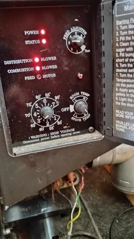

Can you post a photo of your controls? Like this

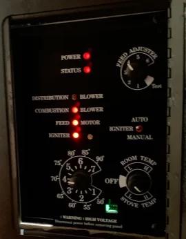

Good news I think. I went down and set my stove in room mode, igniter auto, then turned the temp dial down. The status light went out.

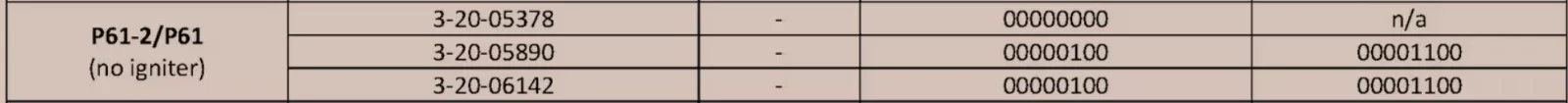

Do you remember the dipswiches? Review the chart again:
The two columns are for different ESP probes (colors of the wire) the other ones tell it there is no igniter.
You stove think's it has an igniter set to auto which is why it is shutting off.
However - the combustion blower should stay running until the stove cools.
