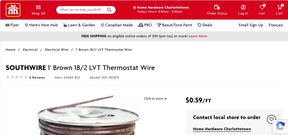

Something like this should work. You would keep your probe, unhook one wire from the stove, and hook this to your stove and probe (in series). Never tried it, but should work. EDIT You would need to install the igniter as this way will shut the stove down. I'd just try your probe first as that will just make the stove go to idle. Here is wire to get at your Home Hardware to extend it. You would just need to crimp on some blade connectors.

I believe from your previous pictures, and from what I read, your millivolt thermostat is wired in series with the probe. You would operate with a high room temp on the dial, then the remote thermostat contacts open when the setpoint is reached. This causes a "fault" in the stove (flashing light) as it thinks the probe is bad. The stove shuts down. Later when the contacts close again, the "fault" self resets and the stove restarts. I already had a thermostat in my basement (the old mercury type) so there were wires already to the back of my stove area where the oil furnace is (was). I cut the probe tip off and pot it inside the thermostat box so you can't see it. In room mode, igniter off, it goes to idle, and the room stays exactly at 70F (in winter/fall/spring). I don't think you can make your's idle unless you want a hookup like mine. It would be easy to do in your case, as the wires are already there. Probes are about $20 down there.
I don't know why I wrote parallel (unless I was thinking about my solar panels LOL). You are correct. it is in series.
Here is the old description of how to hook it up.
That's what I need, who carries them? I just can't have a wire running across my living room floor. Between tripping over it and the cat playing with. Not to mention vacuum cleaners.
I forgot not everyone has a basement - or they have a finished basement so running wires thru the floor is a hassle.
