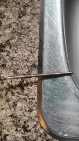

Have you ever replaced your ESP probe? Thats what's monitoring the temperature and telling the circuit board to either feed more pellets or less.
Apparently it either works or doesn't. And if it isn't you get a code, but your right only thing left.

The probes are not too expensive, and if you have black wires now that is really old. You would get the red which is the latest to go with your new boards. I guess board 1 is now a proven spare.

Neither do I, but close is good. I retested it 4 hours later and it was within 10f of what it should be. I just want it to be consistent, which this one isn't. It's like driving a car, when you want brakes, you should get brakes. When I set the pellet stove on a given number, I expect it to be within 10-15 degrees. Nothing like leaving for a couple of hours and coming back to either a cold house or a hot one. I posted a picture of the old ESP, badly pitted and rusty. I mean they want like $8k for a new one, you'd expect the same.
