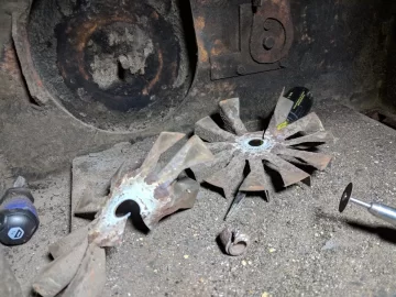

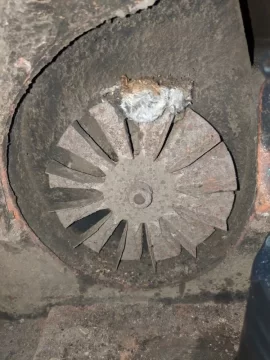

So tons of dust, a few dead mice, yeah TLC sounds fair! Anybody know what size Alan Wrench will take the combustion blower fan blade wheel set screw off? Can't seem to get it.
should be 1/8” Allen. My guess is it’s gonna be frozen there so soak the crapp out of it and good luck. You may end up cutting it off the shaft. Did you try running it in test mode to listen to the motors run
I'll try that but I think you are right, might have to cut it off . Amazing thing is that I don't think I need a new combustion blower after all. Found a petrified mouse ( in addition to the four baby mice under the ash pan) stuck to the combustion fan blades . Took it out, boom, everything works in test mode!!!! Now I have to clean the heck out of thing!
Heat - that is what has worked for me in the past. If not, yeah, drill out the Allen screw or cut the shaft.
This is how that wound up....

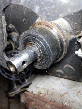

I'm trying to pull the auger to clean. I cut away the red silicone but it's not coming. Do I just pull at this point, pry? Thanks. Didn't want to pull if I was supposed to do something else.
  • [Hearth.com] Used P61, What's My Next Step?
Some that were sealed with silicone were hard to get out,my 06 was.Some that had no silicone rusted in.Feel free to hammer on the front of the auger,with a hammer and a piece of wood.

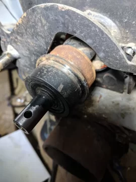

Ha ha, Hammer from the front worked! Thanks Bob! Gonna have to polish this rust off! What should I lube the bearings in there with? Not horrible but definitely can use something so the auger spins a little more freely.
