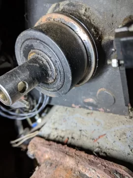

If you look at this photo it looks like there is creosote build up on the part of the auger on the back chamber side next to the auger motor. Does this imply that the auger bearing is leaking smoke? Or does it imply something else? Or is it nothing? Thanks.

The auger bearings are sealed and part of the auger. The best design and durability I have seen in a pellet stove. :) The creasote there does not indicate anything but what I do is clean it all up with a wire wheel on your drill driver and you can also spray the auger with dry moly for extra lubrication. After it is clean just spin the bearing and make sure it spins smoothly with not hiccups or glitches. If it is not smooth spinning then replace the auger. They really do not cost that much for their superior high quality! Let us know.
Also Harman states it is not necessary to add any high temp silicone when re-installing your Auger. :)
See pics of one of my Harman Augers here
https://www.hearth.com/talk/threads...een-cleaned-in-over-10-years-see-pics.168620/
Also check for any Harman Auger Pox! See pics
https://www.hearth.com/talk/threads/holy-harman-auger-pox-batman.109241/
After 5 years of replacing that little white plastic auger bearing every season on My Magnum Baby, hearing that the Harman auger bearing design is the best makes me pretty darn happy! I'd like everyone to take a moment of silence to observe the mouse who gave it's life so I can get this P61 for such an amazing price.

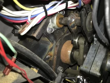

So I thought I remembered everything but can you guys help me with the orientation of this piece under the auger motor. Not sure what it is but it has a wheel and the set screw for the auger. Is it put on properly? It must spin with the auger and move the pusher arm? Thanks!

Looks like you've got it in there correctly.

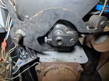

Here's mine:

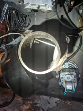

So the ESP in this old stove is held in by a bolt with a nut inside the exhaust pipe. This can't be right, no? Every time you clean the pipe you'd have a heck of a time with that. What's the proper setup? I imagine tapping a slightly wider screw right into the pipe, no? The nut just seems wrong. To make it worse the nut is rusted to the bolt so I'm going to have to cut it off. Thanks.

I clean my esp with a nylon bottle brush, I never remove the esp. And I brush out the passage with a rag tied to the end of an old broken off rod to my pellet stove brush set. It's just fluffy ash in there, both in the passage and on the esp. My esp hasn't been out since the first year we put the stove in. At least 5 years anyway since I've pulled it out.
Well anyway, ya if you want to lose the nut then I guess tap some bigger threads.

Did I read that right? You got a Harman P61 for $75 bucks?! Also, the Room Sensor probe ends should look like this. https://tinyurl.com/y5aeyxx7 Also, the ESP probe is indeed supposed to be connected that way. I pull mine out every year during my deep clean and LIGHTLY brush it down and clean it off. I have a backup esp on hand if needed but never had to use it in 5 years i've been running my P38.

agree.. NO REASON to remove the ESP probe.... later Harmans had a small self tapper that held it in place and much easier to remove but still not necessary].
it basically collects ash dust and as a poster here said, get a bottle washer [bristle type] and go back/forth gently on the probe to clean it.
