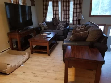

Hello folks. I am trying to warm up my basement with my dutchwest food stove that is in the living room. I have done some research and please see attached pictures for a better understanding of what I'm purposing. I am thinking about cutting a vent into the spare bedroom and running 6 in duct all the way to the floor below which is in the utility room and using a inline fan to suck cold air from basement floor and push it into the main level hopefully causing the heat to move down the stairwell and into the basement.
I have a ceiling fan in the stairwell that could give a boost if needed. But I have tried almost everything else between doorway fans and small box fans and small table top fans in all different areas of the house. I was also thinking if this didn't work if I cut a register in near the hearth and that would be above the finished portion of the basement I could box the register and pipe in below and run the register down to the floor. Does anyone have any insight on this

I was thinking of cutting in both registers having the one in the spare bedroom push air up and that would in theory create a negative pressure in the basement and cause warm air to move down stairs through the stair well I'll attach pictures of the interior and if that doesn't work I would cut in register by the stove would o be better off to just use both registers on either side to move air down?

You might move more warm air down if you could put the registers up high in the stove room with ducting down to the basement and have an inline fan in the downstairs register pulling the warm air down that way. By having the registers on the floor upstairs , you would be trying to pull down the coldest air from upstairs which may not be as effective.

What I was thinking. He would need to position the ducts high on the wall in the stove room and near the floor in the basement to have any chance at all of moving warm air down.
It's not going to happen without scavenging the heat at the top of the ceiling and blowing it down in an insulated duct. Even that may not be enough heat to keep the basement comfortable. Warm air is lighter and is going to want to rise.
