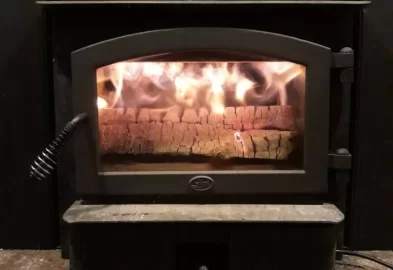

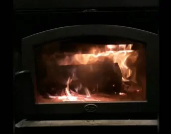

Once the stove and flue are hot, you should be able to run it with the air turned down and still maintain flames at the top of the box. Your secondary air tubes at the top of the firebox introduce hot air that will ignite the smoke in your stove. So in a way, yes you will be smoldering the wood. But then the smoke should burn above the wood.
Not every setup will run with the air totally closed. Starting with the air 100% open, then closing it in a few adjustments to a final 10-25% open is pretty normal.
A good burn with dry wood and the air incrementally dialed to a low setting should give you some lazy flames at the bottom and smoke getting reburned at the top.
