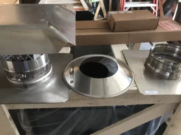

So I'm curious, why do you guys have silicone out in the open like this? If it was installed correctly, there would be no need for sealant in this location. There should be a storm collar or a plate that's designed in a way that prevents water from being able to get near the liner.
Well, if you like the belt and suspenders approach you can do both. But the heats not a problem and, in this particular install, UV rays are pretty minimal with tree shade.
Ah, your photos make sense to a degree.
Looks like there are a few different configurations. My DuraLiner top plate has a gap between the rigid liner & the top plate opening. There is a raised lip, but still an opening. The liner extends up 18", then cap to top of liner. What you have looks like the cap mounts to the plate opening lip directly. And that I would not seal either as it appears to be self sealing.
Storm collars should ALWAYS be sealed. Just the metal storm color to metal liner ain't exactly a water tight sea, as we have already read on here a few times. sealing is a sure way to guarantee no storm collar leaks. Won't be hot enough up there to effect the silicone at all.
I guess it is a matter of what set up you're working with.

The install was 2 weeks ago. The installer used a storm collar (what you have in middle of picture above) on top of a top plate (presumably a similar one with the small lip you described, Hogwildz). Originally, installer went with a more standard top plate for a liner, but determined that the heavy wall flex liner being used might require a stronger setup.
Storm collar to liner Connection looks to have maybe a 1/16 inch or so gap in spots where it meets liner. Liner sticks up from collar about one inch. While I doubt significant amounts of water will get in that small opening, I want to ensue that the wrap insulation on liner stays in good shape and not sure if small amounts of moisture will impact it.
The silicone would be easy enough to apply to this very small gap. Just want to make sure there would be no drawbacks to it being used to seal that spot.
The silicone will be fine. If you want to go the extra mile, you can use urethane, but urethane takes long to cure. Both will do the job. I seal all storm collars, and if you can see a gap, you already know you will be up there at some point sealing it, so might as well do it now and be done with it. Sucks to have to deal with when it is raining, or worse yet, when there is a foot of snow on the roof.
Remember, silicone only works well when applied well. Make sure you clean the area with rubbing alcohol, brake cleaner or similar product the cleans the factory oils off the area your working, but leaves no residue. Otherwise the sealant will not adhere well. Silicone should be worked in with your finger, in both directions.You can even work it in with a swirling motion, looking similar to a welding seam. Just don't pump it on in a bead and call it good, it must be worked into the surface.
