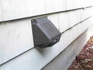

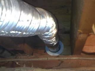

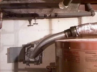

Guys , with my pellet stove I went through the ash dump, then increased my vent
to 3" for the last 5 or so feet, exiting into a 3" dryer style vent
but removed the flap inside.
Installed it a couple weeks ago and it's working fantastic.
Excuse the crappy cell phone pics but they're all I have of the intake.
