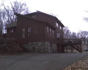

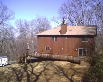

exploring this, what can be done to improve exterior air leaks? wont have funds available to wrap and re-side for a few years...
_1 phota was taken in evening, camera facing NE. cold winds come from the right of picture 1150 (left of _1) from accross the valley.

No, sealing the boxes won't hurt.
Our house is very similar to yours. I also spent a lot of time at first trying to address air infiltration at the inside.
Then I had an energy survey done with a blower door test and far IR imaging. This was very revealing.
Given your constraints, and my experience with a similar house I think you time would best be spent making sure weatherstripping at doors and windows is tight, sealing around doors and windows with expanding foam by pulling the trim. At our house this space was stuffed with fiberglass which you'll find serves pretty much as a good air filter only. In many cases the door thresholds are not adequately sealed to the floor deck.
I'd also check all mechanical exits for driers, vent hoods, bathroom vents etc. to make sure they're sealing well. Our drier vent was hanging wide open because of lint buildup. Our bathroom vent hoods didn't seal well so I replaced them with better ones. If you have cantilevered overhangs you can pull down the soffit board to make sure air is not entering the space between floors there (very common).
Also, focus on the potential leaks at higher areas since that's where your most likely to have leaks because of the stack effect. This is one place where sealing electrical boxes from the inside will be effective.
Edit: The band joist areas above basement wall is also an area where you may be be able to stop air leaks in the outer shell from the inside. I'm doing that now at our house.
