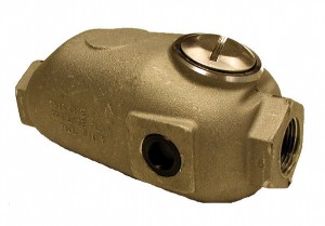

This isn't the exact one, but gives the idea:
We don't put them right on the tool, but have a 5ft "whip" that this goes on. That way the oiler stays on the ground, and you aren't holding it's weight all day.
I'd put a check valve in, a spring type of some kind, piston, ball, etc upstream of the oiler, and a few feet of pipe between the tee and the oiler should almost guarantee you won't get contamination. If you want to get real fancy do like we do in industry, install 2 dissimilar checks upstream of the oiler.
