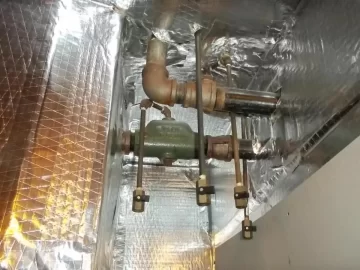

Here's my high-point central between boiler and the tanks. One is the tank top manifold, another is the boiler to manifold pipe, and two are the system load PEX lines through the ceiling to the house.

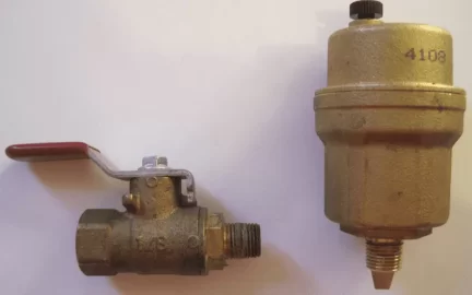

Most air vents have a cap that will seal them off tight. So you would not need an isolation valve to shut 'er off completely.
You can buy these male x female ball valves, some times called gauge cocks if you want isolation and a good shutoff. Jomar, Webstone, most valve brands have these 1/8" valves.
That cast iron "ramp style" purger that E dub shows really wants to have a vent like show here to operate properly. Notice this vent has a small tab that sticks down into the purger to help catch the air bubbles as the flow moves them thru. It's tough for that air to find that small 1/8" hole to escape, the tab helps grab the bubbles from the fluid stream.
Of course you lose that ability of the tab to do it's job if you put it in a check valve as shown above, or a ball valve. Actually that tab may hit the ball in those small gauge cocks, so watch for that.

The question was can you do it with a valve and an air vent. The answer is that you don't even need the air vent, just the valve. In my case the photo was take before the area was enclosed in insulation, so servicing a capped air vent was not an option.
As far as the the air scoop goes, it was all plumbed in before I realized it wasn't even needed, any air would continue to the tank upper manifold.
