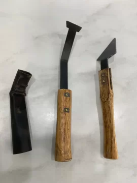

My little nozzle I made actually goes into the slot to vacuum it out after a little banging. I recently cut the tip on an angle so that it would be more airtight on the burn pot top slope. Also great for the fines box.
Not sure if I am actually sucking the dust out, but for sure every time I scrape the burn pot and pull the ashes over the edge those holes get some ash in them. I think that is the only time ash should get in there, as the air is coming out of there when the C blower is on.

  • [Hearth.com] Black sooty glass and lazy flame P68a
