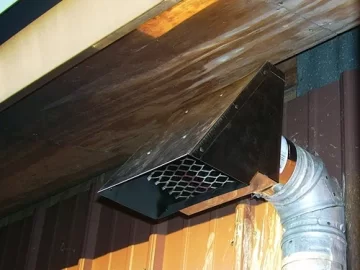

And yesterday I swapped on a box like horizontal flu cap in place of the old round tapered one, and the stove is breathing even better now. I did it as a test as no matter which way the round one was pointed, wind was fighting the stove. This new one has a sloped side facing any wind coming straight in at where the opening was, and I guess that slope deflects the wind up and over. Was a test, but looks like I'll add a brace now, it works so well.
I added the expanded mesh to keep birds out, it was painted already when I found it on the road side all those years ago.

Water in clean out cap?
We were away for the Christmas with family, but just before Christmas, when I wrote the above post (#8), I forgot to ask about others maybe finding water in the SS clean out cap. I know moisture is a byproduct of combustion, I know it will condense on cold surfaces, like exhaust piping.
On the day I swapped that pictured vent cap up top, I had removed the SS cap on the lower end of my clean out tee. I neglected to say that I found that cap full of water, like you filled it under a faucet.
I had just had that cap off maybe 3 weeks earlier in first of December, cleaned it, and reinstalled it with the nickel anti seize on it, and we had run the stove on low maybe 2 weeks total since. If not for a cleanout tee, it'd been a mess. Attached for reference is a picture as it's existed since at least 2020 (changed after we re-roofed). I had a tapered horizontal termination on it, had experimented with a longer horizontal run (over that open carport window), but this what is now except the new "rectangle/trapezoid" horizontal cap that is now facing the camera (and which I braced before leaving)
Anyway, it surprised me at the quantity of water accumulation in just a few weeks, and I wondered if anyone else had seen such in such a short time? My old clean out cap had a couple small holes in it that let water drain, maybe I added them and simply forgot, you certainly would not want holes draining black sooty water in a house.

I think you will get less water with the new style cap you installed...
That thought occurred to me too, we had had some serious wind and some rain just before that, was why I had gone to town and got the new termination piece / cap.
Stove for darn sure likes this new cap.

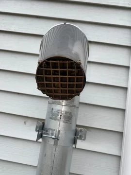

Here is my type. I believe they call it a nozzle? It has a good slope and it's on the north side of the house under the soffits. There is a house further north which would block the wind a bit. I did not see any evidence of water in the tee next to the house.

Might be the name for sure. Mine was under the overhang of the attached carport, it too was sloped downward, worked
ok I thought, but the new one is better. No matter which way is pointed, it has the house or carport from the south east to the north west behind it as that side of the structures face south west, and prevailing winds here come out of the west to south west. I built my house in 1990 not planning for a pellet stove with nozzle. For years had a 360 degree vent cap, but put a metal roof on in '17 and decided no piercing. Even with a sloped nozzle, any wind hitting it at the opening will fight the combustion fan. We had some serious rain with wind, might have blown some in.
Tomorrow is gonna get real windy, it'll be a real test of this horizontal cap that only has a big bottom opening, with the slopped face above it. If needed, if it doesn't work as I think it will, I can next add a longer sloped face panel for that surface that will only extend below the opening on the wind facing side. We'll see.

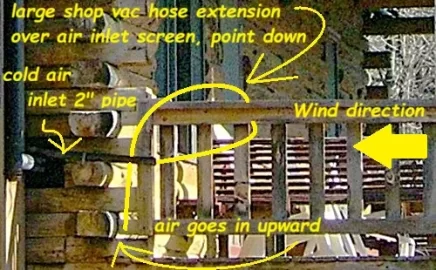

Since long ago, like 1992, I've had a cold air inlet made of 2" OD (same as stove inlet) car exhaust pipe (for combustion air), it goes through the same wall thimble as the flue, over at the upper corner, it has a screen on the outside end, and it comes out of the house and turns 90 degrees and is secured to a log end at a very slight downward angle.
Today, wind is up still, and I heard a big long gust hitting the house as I was watching the stove, thinking how well the stove was doing, etc .... and suddenly the stove flame became more intense, livelier too, like it got a good dose of oxygen .... then I sniffed a trace of smoke. We had long gotten used to it, was very faint and we figured was smoke from outside maybe hitting the house, maybe a seep through a joint? For some reason today, I gave it more thought, then reflected on the cold air inlet.
Then it hit me. When I put the stove in and all that goes with it, I was focused on not letting rain or bugs in (slight grade of pipe, screen, etc) and keeping the inlet away from exhaust. I never considered that I had pointed the pipe right into the prevailing winds here._g
So today went downstairs, grabbed an extension hose for my big shop vac, and slipped it over the end, looped it through the porch railing, and pointed it straight down, secured to the rail and the inlet pipe with zip ties. Since then this morning, no smell at all and the stove flame appears unaffected by wind. I think maybe the wind was like super charging the air inlet and reducing vacuum in the stove that pulls combustion air in (thanks to the exhaust blower) momentarily pressurizing the fire box, maybe the whiffs of smoke were through a door seal. Fire would still get more oxygen, but it being pushed instead of sucked in, like adding oxygen to a torch?
Tomorrow I'll stop by a car parts place and get me a turn down. Really old picture used to explain.

Here's my setup based on 3 inch. The outside air is the grey vent near the garden hose. It was already there. That is the old furnace room and I guess the oil burner needed fresh air for combustion and venting. BTW, My nozzle of off for cleaning. Also, there is a fine mesh screen inside the vent.
