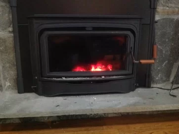

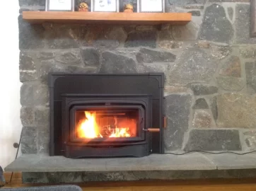

I recently had an Blaze King Ashford insert installed. Great looking insert and long burn times but I'm having problems with how dirty the glass is getting. It was my understanding that the glass would get dirty on low setting and would clear up when on high. It is not clearing up at all. Could I be doing something wrong or do you think the unit is malfunctioning? Any input would be appreciated
What sort of wood? How seasoned? Do you measure wood moisture content? If so how?
What is the installation and chimney configuration? Do you monitor temperatures? How?
Pictures help a lot.
,And welcome.
Reactions: Blazing and lsucet
Well, the first question is always going to be about the wood. Fire wood for EPA stoves need to be cut split and stacked )CSS) for typically two years. Other things in question would be chimney length and possibly operation.
EDIT; See!

Wood is over 2 years old and split and stacked. Just tested moisture on a few pieces for the heck of it. All between 15 and 18 percent. I don't think wood is the issue. It has a built in thermometer. It doesn't give actual temps just color coded. When it's in the red it's at proper tempature which it is. Chimney is only 15 ft. I have a slight smoke smell from it also but also but not bad at all. So you think it's a drafting issue? I didn't realize that caused air wash issues. It was mentioned that a chimney extension may be needed but I thought that was if it got smoke issues.
When you tested the wood moisture was it on a fresh split? My sirocco can go a year and not look that bad. I scrap it with a razor every 3 months or so. Also sounds like draft might be a small issue. Any chance you can lengthen your chimney another 2-3 foot?
The wood was split a couple of years ago. I really think it's fine. I guess I don't understand the physics on how it cleans the glass. I can put an extension on the chimney if necessary but I would like to be reasonably certain that's the cause of the problem before doing so.
