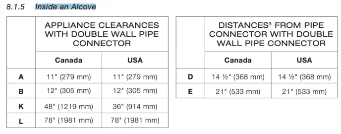

We are doing a new build and want to build an alcove for a 29 1/2 in tall, 18 3/4 in deep 24 1/8 in wide wood stove. Wood stove store guy says our alcove must be 73 in tall!! Is that right???

See section 8.1.5, right hand table.

Looks like it has the same firebox as the Osburn 1700. Alcove ceiling height is specified at 78". The rear clearance is 14" in this type of installation.

There are a couple of workarounds, but they require that the entire alcove be built out of non-combustible materials. This means no wood studs, drywall, etc.
