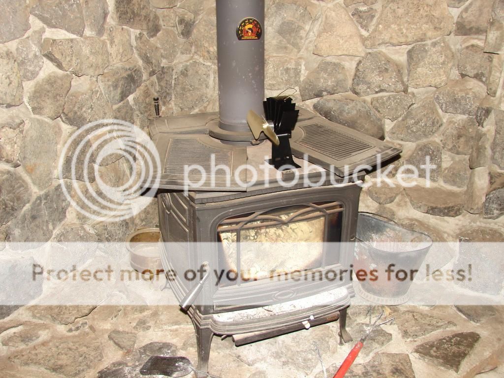

Hi dochockin..
Just read your thread here and am in the middle of trying to figure out what is the best way to get this ecofan working right on my T5? Buddy of mine gave it to me yesterday and i like it alot as its pushing hot air into the den which is to the left of this picture. Havent heard of the soapstone fans but will be watching this thread to see how you make out :cool:
I might even take the right hand trivet off the stove ::-)
Hmmmm! looks like the top could use a good dusting ;lol

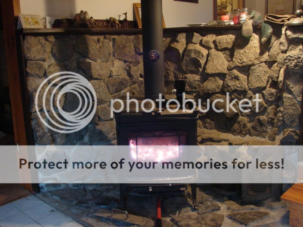

Took the grate off and the fan is pulling cool air in and hot air out >>
But Mrs loon aint too impressed with the look of it !!! ;)

Hey Loon, just so you know.. my T5 door looks just like that during typical burns.. what kind of single wall temps are you getting on reloads, and does you pipe temp sometimes go up like hour or so into burn like a short spike up... thanks, The jet
Hi jet :cool: Still pretty mild here so running the T5 pretty much closed :p
It does just go into the burn zone then cruise around 250f,trying to remember from last year about the spike? but not sure?
Its supposed to go down to -10c tonite so hoping i can get the afterburners blazing and will keep an eye on it to see if there is a spike >>
Pretty sure the glass is like that from pulling the coals forward for the reload?
loon
Hmmm, my glass stays clear at the bottom. Check your gasket, especially around the bottom. Make sure there aren't any fragments of coals embedded in the gasket. It also might be worth doing the dollar bill test on the bottom the next time the stove is cool enough.
Was thinking the same thing last week bg and it seemed fine? We still havent had a good day with a full fire as it gets way too hot in the house..
I'll blame Mrs loon for that ::-)
Sounds like you will be able to fire it up with a full load tonight. If that doesn't burn off, check the gasket seal.
Will do :cool:
How's the T6 running this year?
Not too worried about the soot on the glass as i am pretty sure it has something to do with the coals and slow burn ;)
