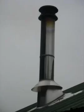

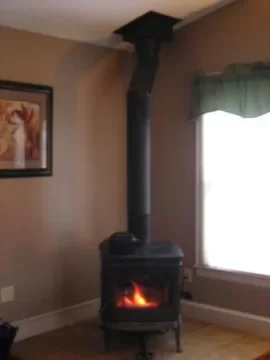

I took a look with my scope and while the cap is as dirty as I've ever seen it you can still see through the rings on the side of the cap. I attached so pictures of the cap and the entire installation.

Can anyone tell from the photos above to what extent the cap might be clogged. There is not a screen in the cap and when you look straight up the flue you can see the underside of the top of the cap.
Thanks,
Dan
No screen in the cap, but it does show dirty burning. If that is the entire flue assembly, it looks very short, like 10ft total. Is that correct? If so, there is the problem.

Looks like a little build up to me especially if you can look straight up the flue but not a show stopper.. Milder temps and a short chimney can lead to a low draft.. Did you check your manifold and what did you see?

This is the first time I have had any trouble with the flue, what you see in the pictures is all there is (plus about 18" in the trusses that you can't see). This is my third year burning and it rarely cools down between November and April. I would estimate there is between 12 and 15 feet of total vertical flue.
Try running hotter shorter fires to enhance your draft t least until your flue is hot.. Your flue and cap seem OK to me other than being a bit short..
Ray
Yes. it surely doesn't look like you've got 12 feet there. About 5 1/2 in the stove room if you have a standard 8 foot ceiling, 1 1/2 feet in the roof area, and then what is showing above the roof....which does not look to be 5 feet. Even if you have 12 feet, that's short, and not surprising as the weather warms that you have a slower draft. Hotter chimney will help a bit, and good dry wood. I'd think a braced chimney extension might be in order. And a clean out from below while the stove is cool may also be helpful.
You may be right, it is a cathedral ceiling and I just measured the distance from the top of the stove to the ceiling box and it is right at six feet. I guess what bothers me about the total height being a factor is that this has worked flawlessly for the past two seasons and only started doing this a short while ago.

Yep, if that's 6 inside and maybe 5 outside, plus the attic space, you're at less than 13'. Take a bit off for the angle in the house and you're short although I don't know what the T-5 needs.

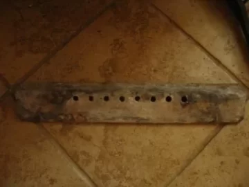

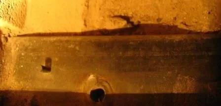

Just got through removing and cleaning the boost manifold - it was absolutely full of ash, even the holes that face the firebox. The air intake hole was covered as well. The pictures below show the cleaned up parts I just mentioned. I'm going to start a fire and see if there is any difference then look at the flue if not.
