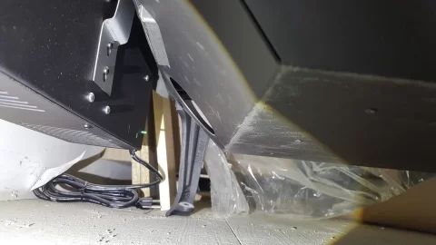

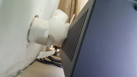

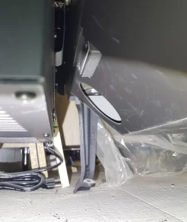

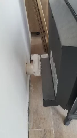

Does anyone have a T6 with BOTH blower and OAK installed to send some pics of how this was achieved?
Im attaching a few photos I took today - as you can see with the blower installed it sits right in the way of the duct work that used to go into the stove

Got it — rear exit straight through the wall is the hardest configuration on the T6 when a blower is added, and you’re not imagining things. On the Alderlea T6, the blower and the rear OAK port physically compete for the same space.
Here’s the straight, no-nonsense answer.
Short answer​
With a rear-exit OAK directly behind the stove, you generally cannot use the standard Pacific Energy blower and a straight rear OAK connection at the same time without modification.
The blower housing blocks the OAK collar location.
This is a known design conflict, not an installation mistake.
Why this happens (specific to your setup)​
  • The rear OAK knockout feeds into the ashbox air plenum.
  • The blower mounts across the back of that same plenum, sitting exactly where a 4" OAK pipe needs to connect.
  • There is no factory offset adapter from Pacific Energy that clears the blower.
  • The manual implies compatibility, but does not show a rear-exit OAK with blower installed, because it doesn’t physically fit as-is.
Installers usually discover this only after the blower is in hand.
In my book this is a FAIL on the PE side and the dealer who also was not aware of the issue prior to selling me the T6
To me it looks like having the air come in at a 45 deg angle would work?
They changed the design to the detriment of this configuration. The older T6s had the OAK intake on the bottom of the plenum. That could still be done with a patch over the factory location. Or as stoveliker suggested, a modified 45º elbow could be made to work by making the male end into a connector by cutting alternate tabs on the end.

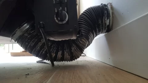

Hello Pechka. Did you happen to develop a solution for this issue, and if so, do you have any updated pics? I'm planning a T6 install with OAK and blower. I presented this conflict to the dealer who reached out to PE. Dealer got back to me and stated that PE's suggested fix is to install an adjustable elbow to lower the attachment point for the OAK duct. Just curious how your situation turned out. Thanks.

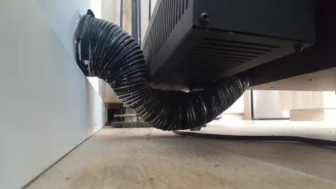

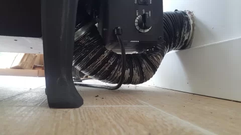

The local dealer I purchased the stove from came up with a makeshift solution using some flex ducting. Not particularly impressed how it turned out as this solution heavily compromises on the cross sectional area of the pipe and therefore the flow, however i have a straight up chimney through the roof which draws quite a bit, so i do not think if affects the stove performance. If it did it's probably negligible as my stove smolders the wood now if i turn the air flow all the way to the right /absolute min/, which i almost never do to compensate for that. Other than this and the aesthetics it works and it's probably much better than without the OAK. If I had to do this again - I would have opted for the T5 and avoid all this hassle, in hindsight I believe the T6 is oversized for my place anyway
Reactions: NEPA_FireOnTheMtn
here are some pics
probably already too late, but if u can - drill the hole through the wall lower so you dont have to go back up with the ducting as in my case

When the air control is fully open, the stove draws all its air from a very small hole. It’s an even smaller hole when the air is shut down. Your ductwork isn’t the bottleneck. The only time it needs the full 6” exhaust volume is when the door to the stove is open.
