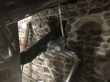

Alright guys just joined and I have a question regarding creosote buildup. I have just installed a UH-Max caddy (the green one) that I got off of Craigslist. Everything works as it should, I’ve got a static pressure of .24 on blower speed one. When I have a hot fire I’ve got a draft of .05 to 06 and when the damper is shut and fire is smoldering I’ve got a draft of roughy .03 to .025. Now here is my dilemma, I live in upstate New York (Syracuse area) and have an outside 7x7 clay flue chimney surrounded by CMU blocks. Local block company here sells the clay flue and CMU all one piece. Now does anyone here have a similar setup because I am worried that when the damper is shut and smoldering that I’m going to have a creosote factory in it. 2 story house chimney is about 3 foot above the peak roughy 25-30 foot high.

That doesnt sound good...when the firebox is up to temp and the damper closes, you should not have a smoldering fire...you should have nice secondary flames in the top of the firebox. If it doesn't do this I would say your wood may be wet...which that mixed with a too big masonry flue (49 sq inches vs 28 sq inches for a 6" round) will make for some creosote in the chimney for sure.
Can you pull a 6" SS liner in? I think that low draft after the damper closes would improve a lot with a 6" flue...
my Wood might be a little wet, 15 cord of firewood cut in January and stacked in May. I’ve got a fan on it now in the basement where it’s next to my furnace where it’s hot and dry. I’ll check the moisture. But the manual calls for a 7” round flue with the wood oil combination and a 6” round flue for just the wood furnace. I’m thinking maybe a 6.5” liner might work. But I’m thinking with the damper completely shut I’m not going to get a good hot fire either way. I went and checked my flue temps yesterday after the damper was shut for a while and the top of my chimney flue was 70 degrees and it was nice and clean after 2 weeks of burning so far

I guess I missed the part about it being a wood/oil Max Caddy. Not sure if anybody makes a 6.5" liner...I know they make 5.5". If your unit is supposed to have a 7", then the difference between 7" square and 7" round is not as great (38.5 vs 49) as if is supposed to run a 6", but the masonry still tends to run cool, (and you even said it was only 70*, it would ideally be over 212*F at the top) which kills draft, and makes creosote.

Might check with SBI, see if they will allow you to run a 6" liner (often times you can go up or down one size)...I think a 6.5" (if its made) will be very difficult to get into your 7" flue...there are often offsets and mortar joints that limit the actual ID to less that the nominal size.

That’s my setup, a 4’ run to a 8” clay then it 90’s straight up to the top with the 7” square.
You have a good fire going there with the damper open...so all the flame is gone after a while when you close the damper?
