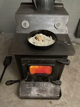

New to the forum here and looking for more info on this wood stove. I was looking for a larger stove and my buddy sent me a picture of this stove in someone’s garage he was re wiring. Growing up my friends father had a mid moe but I have never seen one with a glass door. Told him I had to have it. Got it in the basement and sanded the rust off and got it hooked up. Got it up to temp and seasoned it with vegetable oil. Took awhile to burn off (should have done it outside) but looks pretty nice now. Any info on this stove would be awesome. I also got bit by the all nighter bug and bought a little mow and a box moe. No idea what I’m going to do with them but they’re so cool. Thanks!

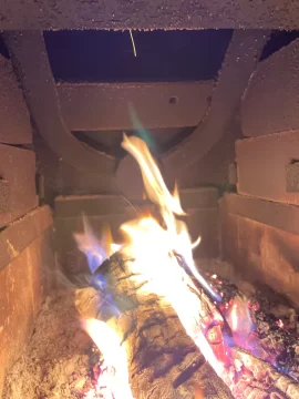

I did a little reading and decided to add a baffle in the stove. Pice of a snow plow cutting edge we were getting rid of at work. Don’t use the damper now and works pretty well! 25’ triple wall chimney kit used but nice, 3 full turns out on intake screws and she loves it.
