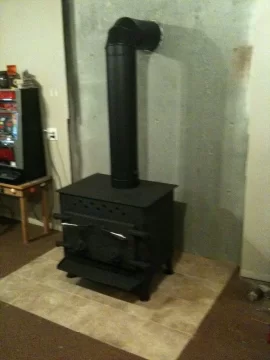

I'm looking for ideas on a new stove. I'm very happy with the old hurricane as far as heat output but I really want a stove that I can see the flame (glass door). So I need some ideas on what stove You fellers think would do me well. Just want to start researching and saving my pennies. Pat
Hears the things I'm looking for in a stove.
glass viewing (want to see those flames dancing)
house is 1080sq ft up and 1080 down
stove is in the basement
exterior block chimney (no liner???)
got to have a blower
The current stove does a great job of heating the whole house. I've got a duct booster fan in the floor above the stove that pushes heat upstairs.
Also will I need a liner with a new stove?
Hears the old stove.
Thanks Pat

If you're gonna do it, do it right. Insulated liner in the chimney, properly sized new stove. Can't tell for sure, but that looks like 8" single wall connector pipe. In all probability you'll be wanting to change that over to 6", depending on the stove choice. How tall is the exterior block chimney (stove to daylight)? Sounds like it must be ~20'. I agree with everything said about going large on the stove capacity. I'm just a bit concerned about this "duct booster fan in the floor above the stove...". If the inlet for that fan is within 10' of the stove, it might be a mechanical code violation...the concern being that in the event of a problem in the basement, the floor penetration will allow the spread of noxious gases or fire to the rest of the living space upstairs more quickly than it would spread without the floor penetration, thus less time to escape. Rick
Yeah I should have specified. Its not directly above the stove. Its out about 12 feet from the stove. Yeah this is exactly why I'm starting the planning stage now so I'm ready to tackle it when the triggers pulled. Pat
