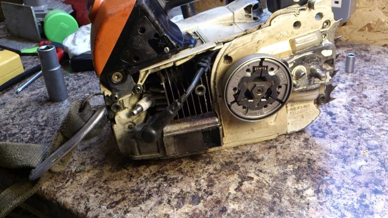

My only other thought would be - is it possible to access the clutch on the other side in any possible way? If you could set something up there, you could keep the pull start just in case, but still have 'electric start' when needed.

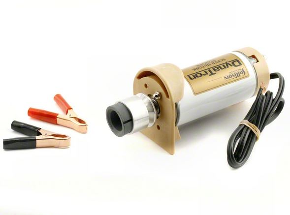

I know model airplane guys use a starter with a big rubber pad which pushes over the nosecone of the prop...just a friction fit. Wonder if something similar could be made to grip the center of the chainsaw clutch and give it a spin?
airplane starter

"a" Stil chainsaw clutch...your may be different
