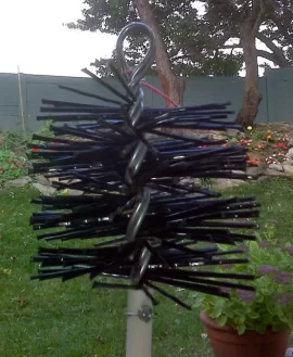

I ended up picking up a 50' coil of 1/2" PEX for $15CDN. I drilled a hole through the braided wires of my poly brush and then cut the 3/8" threaded crimp off the end. I fed this into the end of the PEX and drilled a corresponding hole. I fed a shackle bolt through the hole and wired it in place. Once all the modifications were complete, I realized the brush was 8" and spent a while trimming it down to the appropriate size with a pair of bolt cutters. Worked quite well, though it took quite a bit of force to get around the bends. That SootEater looks nice, but with the base cost, six extensions and shipping to Canada it would end up being pretty expensive.

  • [Hearth.com] Alternatives to chimney rods.
