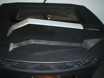

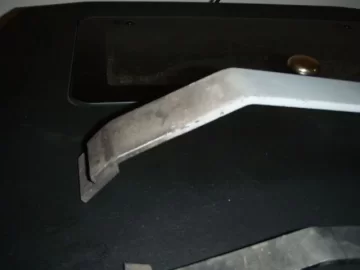

My dealer gave me this big carbide scraper and told me to really get in there and scrape the burn pot weekly with it. He said the Harman tool is fine for light cleaning and getting into hard to reach places like the auger tube. Other than those two tools, I have a screwdriver and a paint brush.
If that is truely carbide I would hesitate to use it on the mild steel burnpot.
A screwdriver bent works fine but even this is harder than the burnpot.
the idea is to have it sharp enough to get the edge under the clinkers and they pop right up.

Yes, it is carbide but you have to use your judgment when you use it- it doesn't mar the metal when you scrape with it. I'm sure you can do way more damage going after the carbon with a chisel and a hammer. I really don't get that much build up on the burn pot since I stopped burning Marth pellets. Once weekly I shut the stove down and vacuum it out and scrape the burn pot- most of the carbon is right in the front of the pot. At most it takes me 30 minutes to scrape the pot and pull the removable panels to clean the heat exchanger and exhaust fan.
