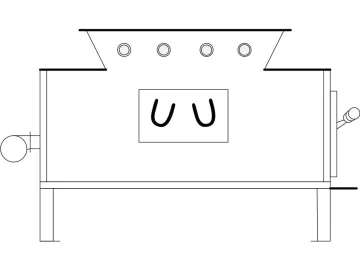

Do you have a picture of the stove? I am almost sure someone here can identify it.
Here's a rough drawing of it from memory.
[Hearth.com] Amount of fire brick lining
