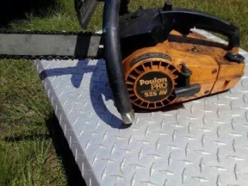

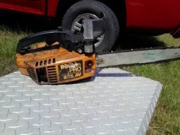

Been thinking with all the posts thissel is putting up about old Macs I thought about my work saw. Went and got it out of the storage area.
Pretty sure it needs fuel lines as they rotted out. If it needs to much work I'll take it in. I'm not footing the bill for their saw. But I have it and can use it. Tiny top handle saw!!

that's not a Mac.;)

haha! Your right! I just knew it was yellow. Did not even notice that I took a oic and posted a pic of. A poulan!
That's hilarious!

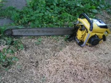

That's not yellow...This is Yellow ::-)
Where's the chain brake???? _g
It never had one. That's one of the first years of production,chainbrakes werent available for that model until the last 2-3 years.1974-77.I started using saws over 30 years ago,not many saws had them back then.The few that did it was a factory option.McCulloch was the first maker to offer them on a wide scale though.
My "mac " do sent have a brake either, just a hand gaurd as its a homeowner saw.. and I Google it, there black and gold ;-)
Anyway, I got it running. After a mouth full of gas I diagnosed that the duel line was good. Man I like one fuel line compared to a gazillion on new stuff. I then expected a busted. Diaphragm in the Carb. It looked fine. Then I thought a clogged pulse port?? Then I saw it had a needle so o pulled it apart and as I expected when I saw it the needle was stuck.
Took a bit of priming bit I got it running. Been 4 Yeats or so since it ran, maybe 3?
