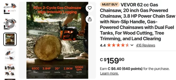

Clone Saw - I buy quite a bit from Vevor. I bought a cheap Craftsman on clearance myself. At these prices it's best to buy two, and get all the spare parts for cheap.
