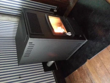

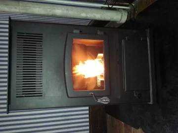

Just got the eco65 hooked up by the professionals today. First burn ever as this is our first pellet stove. [Hearth.com] And we're burning....[Hearth.com] And we're burning....[Hearth.com] And we're burning....
Lol....not sure why the pics are turned sideways. Now to get the new smell burnt out of it and some pellets in the basement.

Wall mounted pellet stove must save alot of floor space. I find the sideways flames most impressive.
It's not big and fancy but already enjoying the heat after one little hiccup. Got an error code 20 minutes after the initial light up. Turns out we just had to reset the stove and try again, but the panic and disappointment was real for a few minutes lol.
Probably from the sideways mount on the wall lmao[emoji6]

Try turning your phone horizontal when taking pics. Nice you will be warm.
Reactions: Darren111
