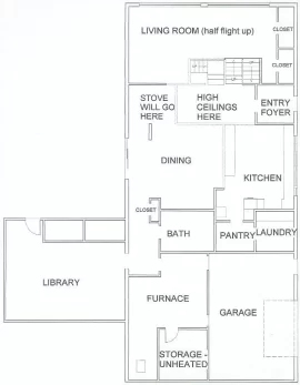

I have a huge barn that is almost converted into a house. There is a wood stove in the library, as that is where we lived for a few years while we started the renovations on the rest of the house. This is a small stove though, and can do no more than heat that area, so we are putting in a new stove (the entire project to be funded, it looks like, by our saving on oil next winter). The stove is going to go on the first floor which is an open floor plan except for the bathroom, pantry and laundry room. The living room is open to this, and half a level up. Right inside the foyer, before you get to the kitchen or dining room, is an area with high ceilings, 12 or 14 feet – the ceiling here is level with the living room ceiling. This area is about 1500 square feet in total, including. It will heat fine and I am not concerned.

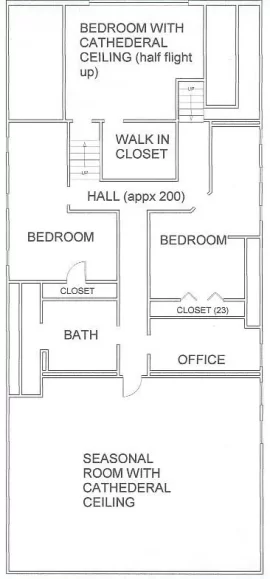

There is a fairly open stairwell leading up from the living room to the second floor. This floor has a central hall and two bedrooms near the top of the stairs, with a bathroom and an office down the hall, furthest from the stairs. This is about 1100 or 1200 square feet.
Another half flight up is a third bedroom, about 275 square feet with a cathedral ceiling and an 80 square foot walk-in closet.

Here are my main questions: The walk in closet is directly above the part of the first floor that has high ceilings. It is adjacent to the top bedroom, as well a lot of the upper hallway. I would like to utilize vents or ducts to move air in order that there is movement in addition to the stairwell. A lot of heat from the stove will collect in that raised portion. I would like to move air from this portion into the hall way and bedroom. It is still unfinished, so putting things in will be easy.

FIVE: I doubt much heat will make it to the big “Seasonal room with cathedral ceilings” past the upstairs bath and office. If I open the door, natural flow up the stairs and through the hall is about the only way to move heat there (other than floor fans which I will not do. I will put a propane stove up there if I need to eventually). However, as with my other question, would putting cold air returns, dropping to the lower level, help at all?

I have posted (or tried to) two floor plans as visual aids. I spent yesterday and today building a new woodshed out of cedar trees, and maybe when I am done I will post a picture of it as well, before I get it all messy with cordwood and whatnot.
