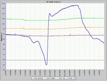

In the meantime, here's a chart showing 'cold lock' in my thermosiphoning solar panels. The temp sensor (blue line) is up by the storage tank. At about 7:30, the panels start to heat up. The panels have to get hot enough to push all the cold water in the buried lines up and through the heat exchanger. It takes from 7:30 until about 10:00 before all the cold water pushed through. From 10:00 on, the panels are heating storage.
  • [Hearth.com] Another dump zone question
