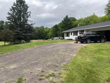

How tall would the exhaust be? If it is less than 15ft that will limit you on what stoves you can use. This would be an even larger issue if you try to put a stove on the main floor. If the basement is not insulated I would spend money on that first. Heating from the basement can be difficult but not impossible. Many do it including myself. I prefer it as it keeps the mess down there.

Here is another photo of the outside of the house to visualize the chimney height, material if you're a chimney aficionado and size of the home.

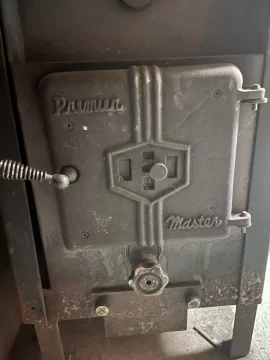

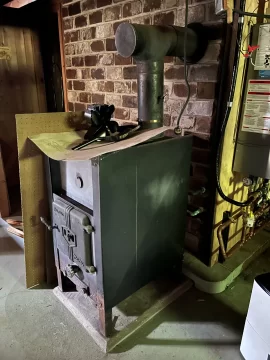

I kinda like the setup. Could you try it as is?, or is it now decommissioned and will never run again. You could replace it with a cheap steel Drolet and new piping. You can keep all the mess and lots of wood down there and not worry about getting it too hot down there. You may stud and insulate walls down there but since the stove is in the center that really helps.
I could try it as is, but was a little apprehensive due to it not have been used for 10+ years and the unknown status of the chimney. That paired with the obvious inefficiency of the stove led me to thinking that an insulated liner and newer stove could be a worthy investment.
Oh yes you would have to go through the inspection and cleaning process on the existing setup if you want to run it as is. Or like you say, just skip that and get new. You certainly don't want to burn twice as much, or produce twice as much "smog".

I wonder if the previous owners were using the T for clean out access? If I were planning to stay in the home for a while, and could swing it, I would upgrade to modern CAT stove… but if not I’d burn that for a few seasons after inspection.
