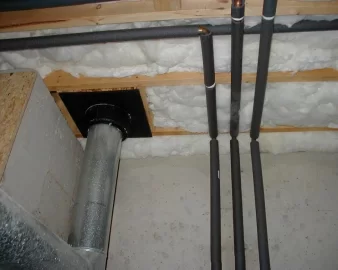

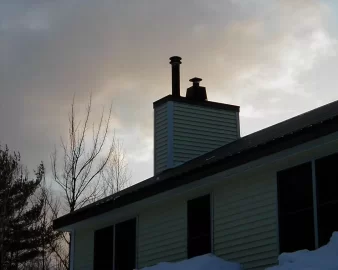

I've been toying with the idea of finishing the basement. The oil hot water system is already set up for a pretty easy install of a zone down there, but it might be cool to have a little wood stove down there. I don't think I would do the stove unless I could fit the chimney up the existing pipe chase. So the chase would have two wood chimneys and one oil chimney. Would this be allowed if they could fit and I guess I relocate all the interfering hot water pipe (see picture)? I imagine outside air would be required in some form, for either the oil burner or the wood stove. Thanks for any suggestions.

Depends how bad you want the wood stove down there. One option would be to power vent the furnace that would free up that flue.
But, Elk, if there was room in the chase and I moved the hot water pipe (again just toying with this whole idea) would it be okay to have two wood burning and one oil chimneys? I don't think I want to do a power vent.
If the chase is as big elsewhere as on the roof, then you can definitely fit another class A in there - not a problem as far as codes.
