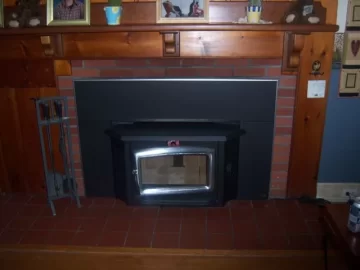

Gosh, in all the pics I hardly ever see any mantels with wood surround here. (nor many flush hearths.) I guess I am going to have a little problem with mine. Do you all know if anyone ever gets more creative with mantel shields or flashing or something to protect the "combustible surround" without having to remove the original woodwork of the house? Here is a photo and schematic of my current fireplace: (ignore the glass doors)

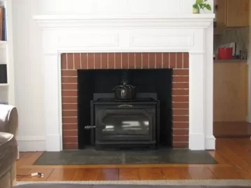

I really would have to measure mine, its been over a year since the instal and I cant remember. Mine was close to minimum. I havent seen any problem and we heated 24/7 all winter last year. Its almost the same set up as you will have. The mantel does get warm, but it'ds have to get danm hot to ignite.

x2 for me as well.
  • [Hearth.com] Another mantel surround clearance issue here!
Nice to see these setups! Thanks for posting the pics and suggestions. That bottom mantle does look a lot like mine, my house was built in 1953 by a mason who lived in it (no chimney problems here, lol)

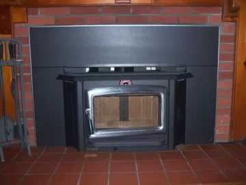

I had to put heat shield on my install also - inspector would not approve it with out one. They look like crap. I will deal with it for this season but next spring I'll fabricate some that looks better.
Wow, your mantel surround looks really similar to mine, the floor too. That ends up being a pretty elaborate setup, huh? Good solutions though, when ya gotta ya gotta.
I was thinking to either try to cover my bricks entirely with black surround, and just do a long mantel shield with the spacers all across the top part (I think I can get away with the sides measurement as it's within like half an inch) so that the brick will be entirely covered, or do the shield at the top same way but leave the fireplace open around the insert (if the insert I get is decent looking enough to do that.)
Good luck! - I might do the same next year, fabricate all new surround panels to cover the brick.

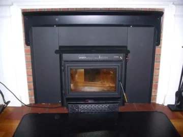

The Vista insert mantle shield is just a small extension that sticks out between the top of the insert and the metal surround. You can see it in my avatar if you look closely (not my stove--I don't have the shield). Maybe the Lopi shield is similar and wouldn't involve that big black shield.
